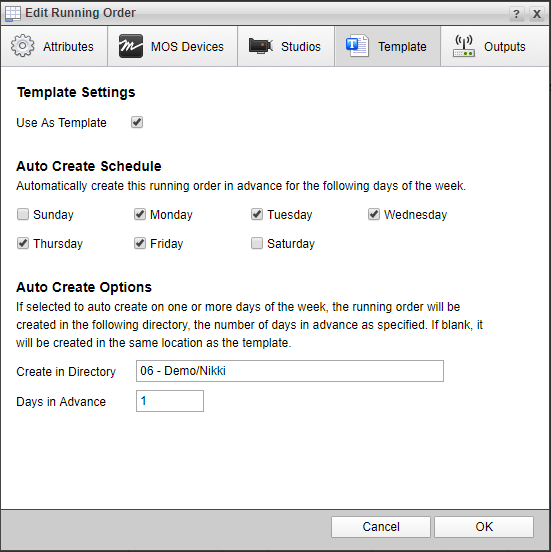

    To sort automatically created rundowns to a specific folder, use a forward slash to indicate the path. Please ensure the folder names match exactly. For example, a directory named: "06 - Demo" cannot be typed as "06-Demo", this will prompt the error you mentioned.
    For dates, you can use the following keys: %M (month), %D (date), %Y (year). These are similar to the keys used to configure MOS Placeholder Templates. Here's a link to that page on the Inception help guide: http://help.rossvideo.com/inception/help/v12.0/UserHelp/index.html#t=Online_Help_System%2FDialogs%2FCreate_MOS_Placeholder%2FCreate_MOS_Placeholder.htm%23XREF_28726_Create_MOS
    If you're still running into issues, a screen grab of the running order template settings, like above, would help.
