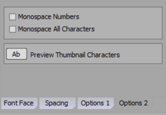

    You can turn on mono spacing for all characters or just numbers here;
