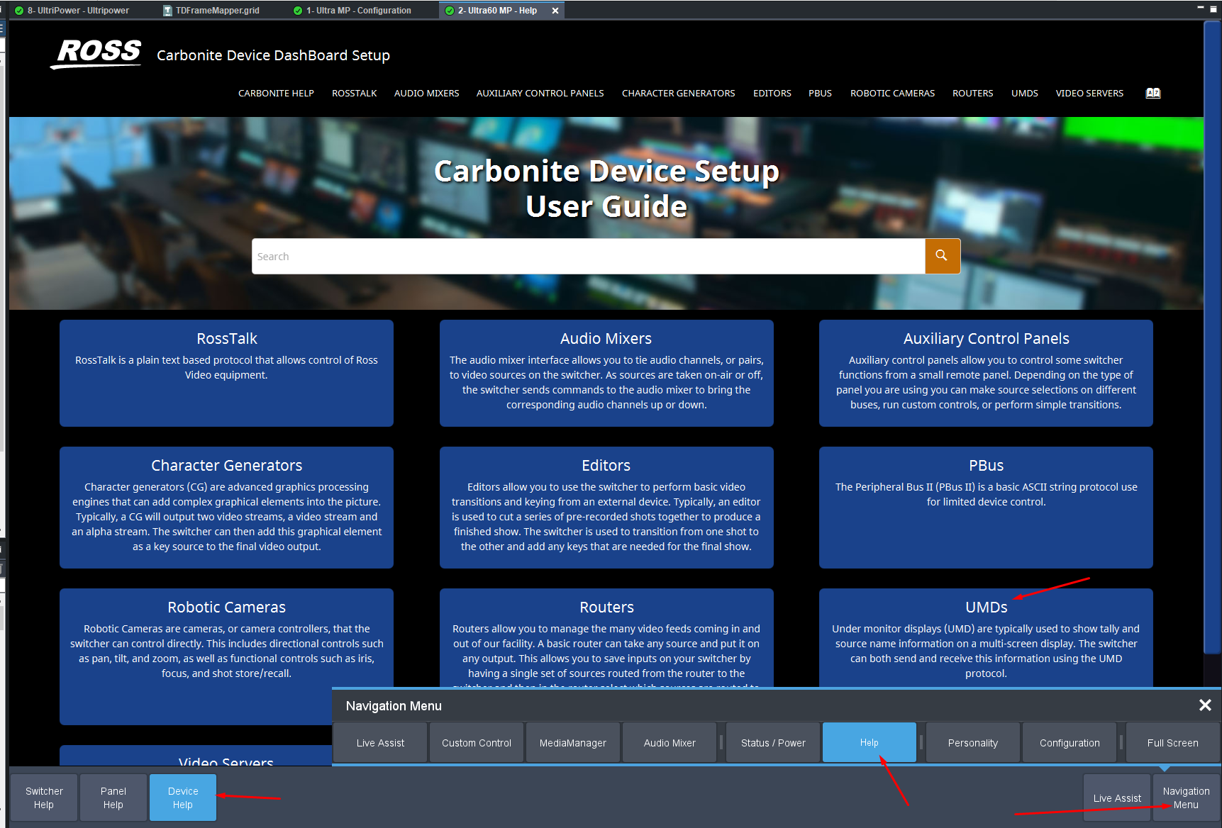

    Yes you need to create a device.  If you have multiple destinations needing the Data you will need to create an instance per destination IP address.
    https://help.rossvideo.com/carbonite-device-db/Topics/Devices/UMD/TSL.html#topic.tsl
    That is the link to the information.
    You can also access the "Help Manuals" directly in DashBoard from the Ultra60
