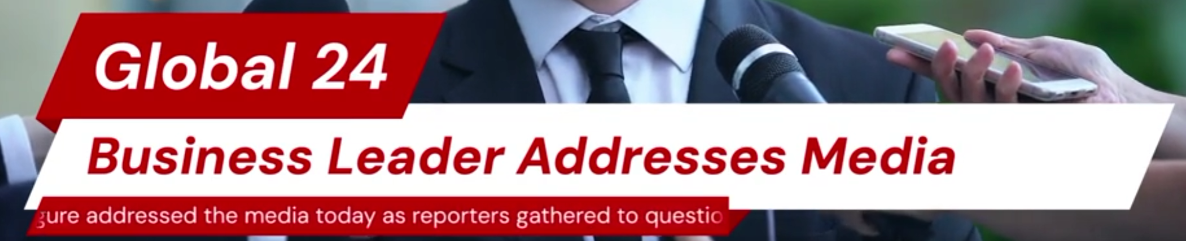

    The crawler should look something like this:
    The bottom line here should be the crawl. Each item consists of a single text box and an image. Like a icon and the name.This is just a template to give an idea since the real version doesn't exist yet. But this is what I would like to accomplish. The only problem I have, is the fact that I can't mask the crawl using the group-crawl function in the sequencer. But using the scene group I can't quickly change the amount of items in the crawl.
    The easy solution would be to just have the design accommodate this and have the crawl run into the screen and off the screen instead of using a mask to border the content. Since this is not the first time I wanted to use a crawl this way I'm looking for solutions for future projects aswell.
