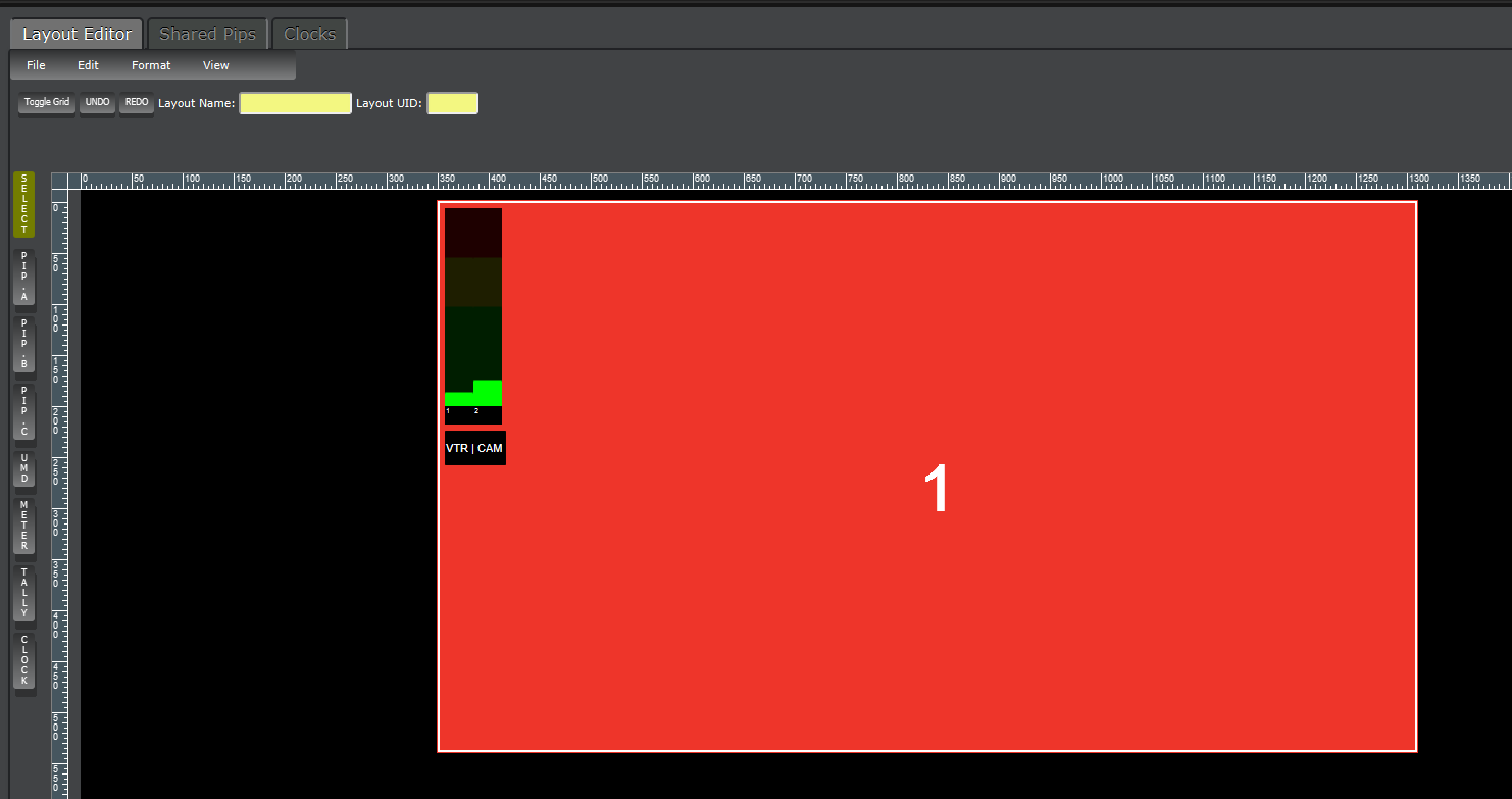

    It would be super useful if we could label the channels on the audio meter bridge in the multiviewer.

    This is a great request thanks you.
    The channels are numbered with our VU meters. You may need an Ultrix software upgrade to get access to it but it is available.
    You can also also use the UMD function to add in custom text if you would like to. Simply use the UMD tool and create a static umd with the text you need and reize the UMD box to match your VU meter size.
