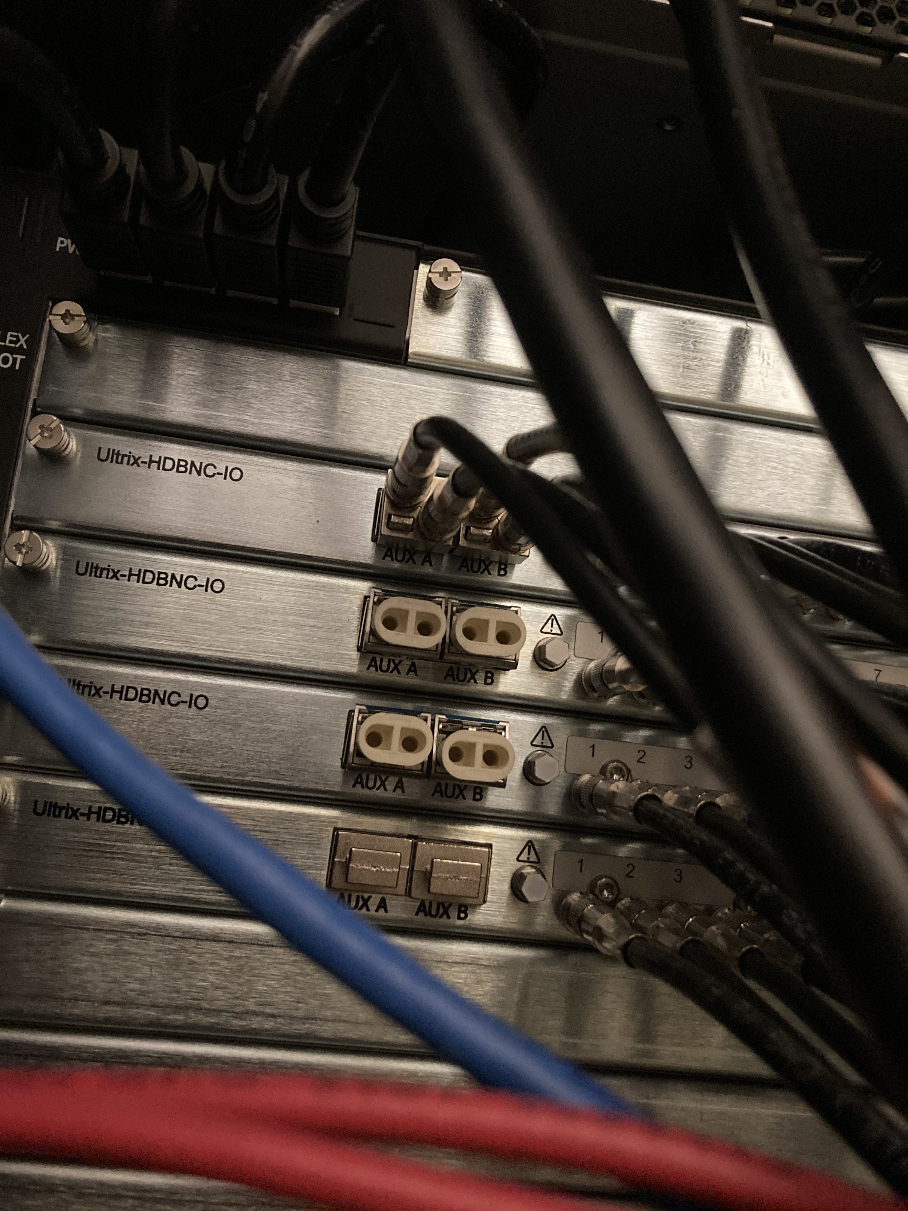

    Hello, we have a 5RU Ultrix. That is already equipped with IO Cards that have Fiber SFPs for the Aux outputs. My question is how do I assign that as an output and then send a signal down that output?

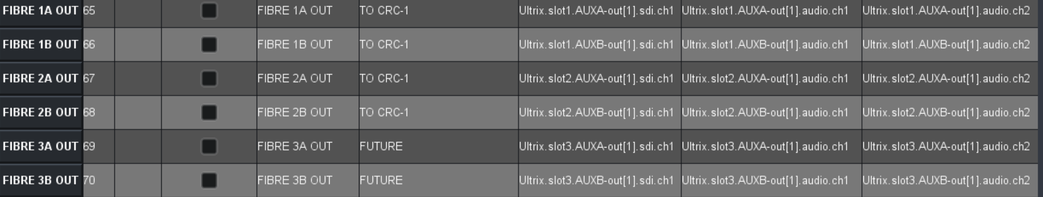

    I've got fibre SFP's in ultrix ultrix slots 1,2, & 3, screenshot attached
    Ultrix.slot2.AUXA-out[1].sdi.ch1
    etc
