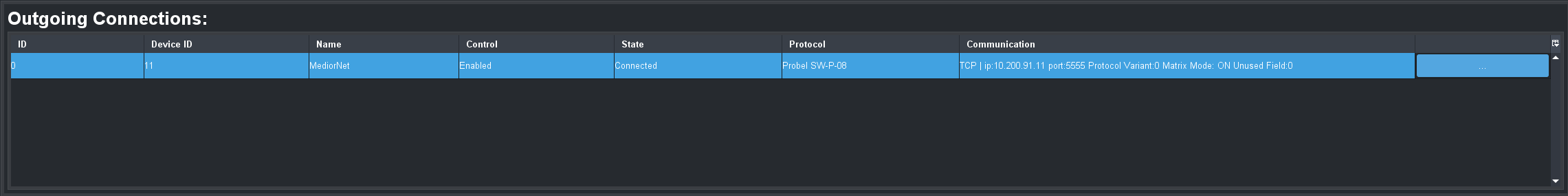

    I'm working with Ultricore BCS and Mediornet and I was wondering if I could add another Mediornet under the "Connections" tab because the system always work with a redundant equipment.
    Just wanna make sure that it will work and it is the same proccess to add another equipment or if there is any different configuration.

    If I understand correctly you wish to control a mediornet device from an Ultricore BCS?
    If this is the case.... yes, you can add another connection so that the BCS can control a second instance of Mediornet the same way you created the first. Essentially you will be adding a second set of crosspoints to your database They will appear with the device name that you entered when you create the second instance.

    Yes, I'm trying to add another MediorNet to my system and I would just like to confirm that I just need to add it on the Outgoing Connections and then on the Third Party Matrices, right?
    I already have a MediorNet with 692 SDI outputs, so if I add another one it would double this number, correct?

    yes exactly...... and you will double the amount of outputs.
