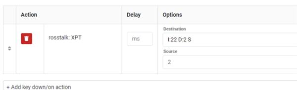

    Here are some tips I found that helped me get the Ultrix switching from the companion application.
    1. Companion UI appears to send an extra 3a (:) command so you will notice that under the source cell location I have only put the ID in the cell nothing else.
    2. I found that I also needed to Identify the panel ID (I) the number can be anything.
    3. After adding the Ultrix as a rostalk device this is what I did to get source 2 routed to Destination 2 successfully.

    Mike is it possible to switch crosspoints only on certain levels? If so, what would the syntax be?
    Vincent Lepore
    FULL SAIL UNIVERSITY
  • 4.  RE: Bitfocus Companion Rosstalk commands with Ultrix
    Posted 06-28-2021 10:50
    yes absolutely, I added in L:1,2 to be able to route only level 1 and 2.
    here is what I put into the source cell.
    I:22 L:1,2 D:2 S
