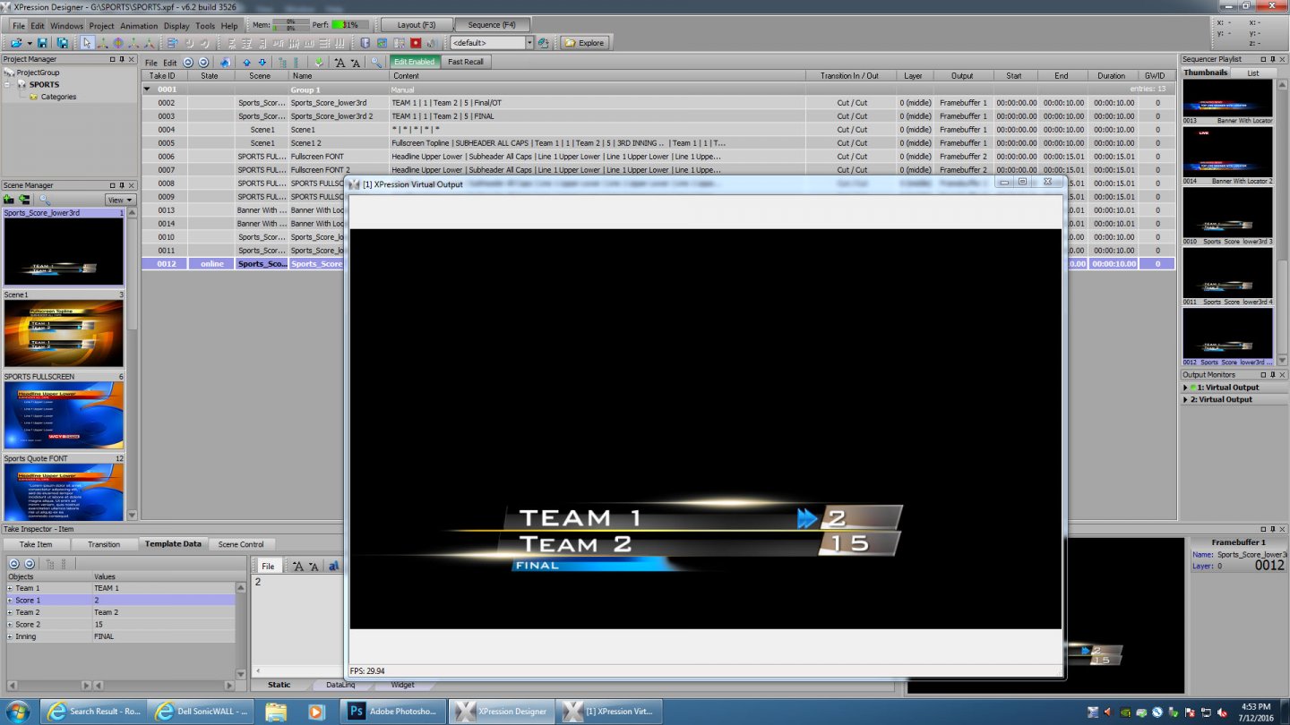

    I'm having an issue with a sports score template I built. I built the template to place an arrow next to the winning score. However, the visual logic I built for it only recognizes the first number instead of the total numbers. So if the score is 10 to 2 it reads 2 as higher since 2 is higher than the 1. This is the only time we have an issue with it. Otherwise it works okay. Two work arounds I've come up with are to put a zero in front of the single number or a space before typing the number. I attached an image that hopefully explains better if that doesn't make sense.

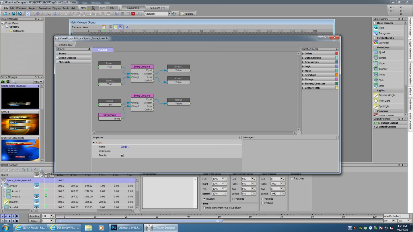

    Instead of using the string compare; try to use the math block "greater than".. You should be able to feed the text object directly into it and it will convert the string to a number.

    I didn't see a greater than block in the Math category but there is one in the Logic section. I tried using that but either the arrow wouldn't show up at all or it would show up for both. I couldn't get it to compare to the other score.

    This worked for me. The bottom branch hides both arrows if the scores are tied.
