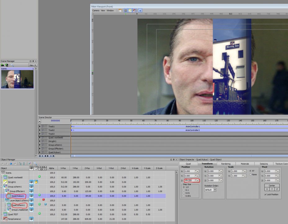

    I have a layer object, since I need to partly mask quad1. So far so good.
    Now I must place another quad2 on top of the layer object (containing masked quad1).
    It doesn't work. No matter what I try, no object will appear on top of the layer obect/quad1.
    What am I doing wrong?
  • 2.  RE: Z Depth Problem - Probably layer object related
    Posted 08-02-2016 19:21
    Normally layers render on top of all non-layered objects. You could put everything else in a layer too; or on the quad look in the Rendering tab and I think there is a checkbox to force it to render on top of the layers..
  • 3.  RE: Z Depth Problem - Probably layer object related
    Posted 08-02-2016 19:26
    I put everything inside the LayerObject. But now a new problem emerges: I can render a jpg on top of quad1 when I put it in quad2 but as soon as I used a PNG with some transparency, the image won't show up at all.
