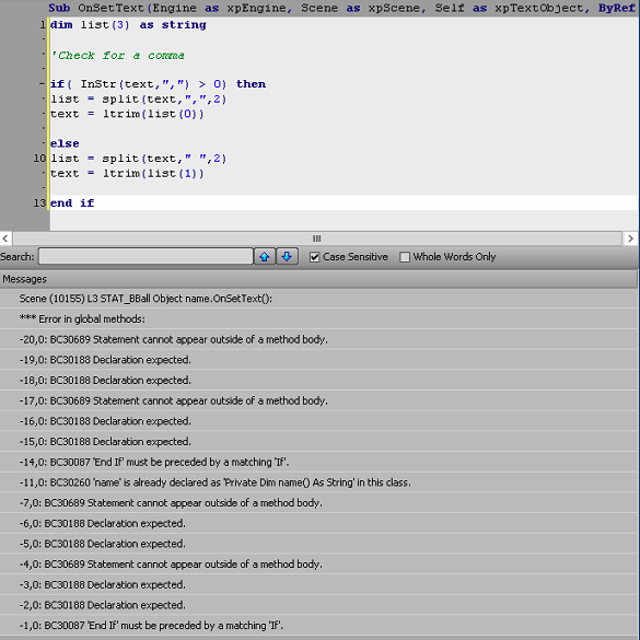

    Posted 11-26-2020 00:30
    Hi Brian,
    Hoping you can help out. Can you shed a little more light on the script you posted above? I'm not super familiar with how to setup scripts and I think I'm missing some steps to make it work.
    When I assign that script event to the the text box i get a number of error messages.
    Thoughts?
    thanks for any help you can provide
