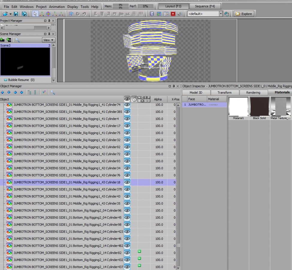

    I'm running into a problem with applying a metallic like material to multiple objects in the Object Manager. I brought in an obj file of a jumbo tron and it has many objects. I'd like to apply the metallic by selecting multiple objects and applying them. I've attached a picture below so you can get a better understanding of what I mean. I'm currently going through each object and applying it, please let me know if there is an easier way to achieve this.

    Try: highlighting all of the objects, then selecting the material in the material manager, right click, apply to selection.
