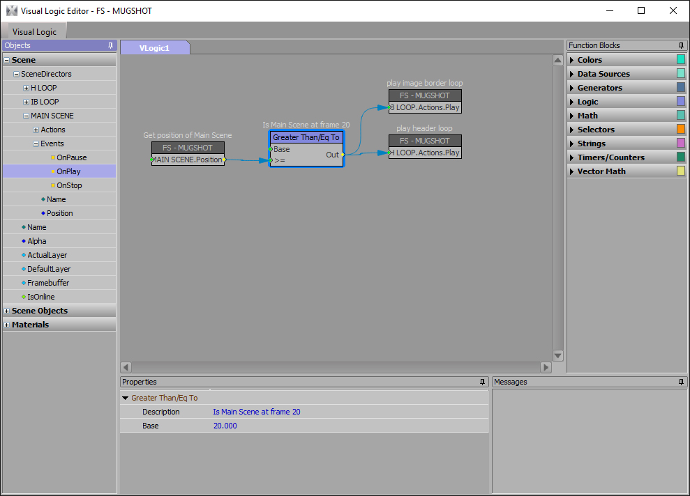

    Hi brhanson, I had a similar problem but I wanted to trigger the other scenes (which are 3 point loop scenes) at 20 frames into the main scene. If you wanted all the scenes to begin at the same time you would use the "OnPlay" node under your main scene's events tab and link it to the "play" node under the action tab of your other scene(s). This is how it looks:
  • 5.  RE: Trigger Render View?
    Posted 01-28-2016 20:35
    Oh wow, yes this is fantastic! Thank you for sharing @cbs7promo
