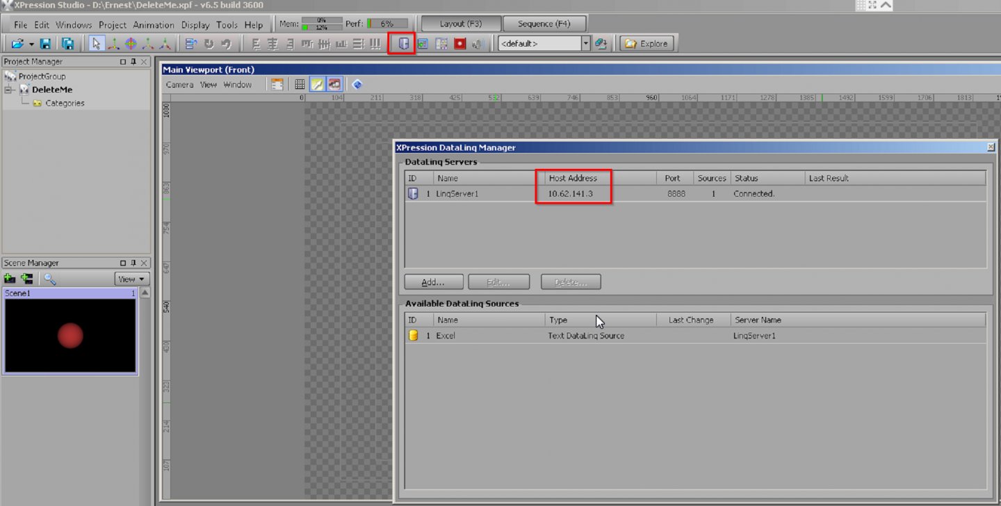

    Not the IP address of the data source, but the IP address of the Datalinq Server in the Project. See this image:

    Dunno why my Imgur link isn't working. Here's the picture.

    Ahhh. I see it now. I'll change that info and let you know how that works! If the Datalinq Server is running on the Xpression Studio I would put the IP of the Studio box, correct?

    I changed the "localhost" to the IP address of the machine running the Datalinq server and published it. I can't get the previews to work still.
