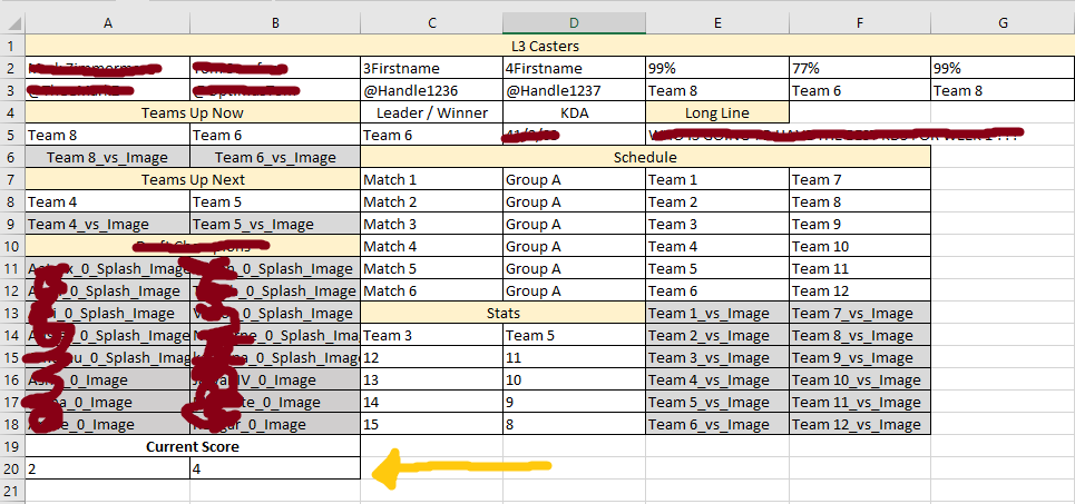

    I am having an issue i haven't seen before. For some reason I can not see numbers in my excel sheet when linking the sheet.
    I have tried to make the cells formatted as numbers, text, and they are back to General.
    Please see images attached. (excuse the crude sensor ship via the red ) Yellow arrow points to one example.
    Thanks,

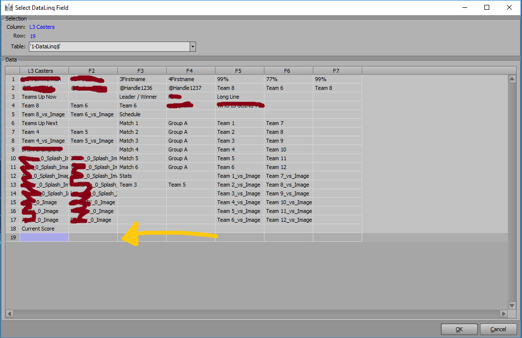

    @shrantz4485 I've downloaded your sheet, but I don't know which fields you are having trouble with.. Can you provide more info about where to look?
    Here is what I am seeing in datalinq for one sample table:
