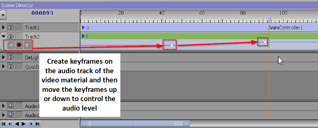

    You can set the audio level on the scene director track in a scene being played out from the BlueBox. You can do the same thing on the audio tracks of a scene as well.
    That's pretty much the only way to control the audio level.
