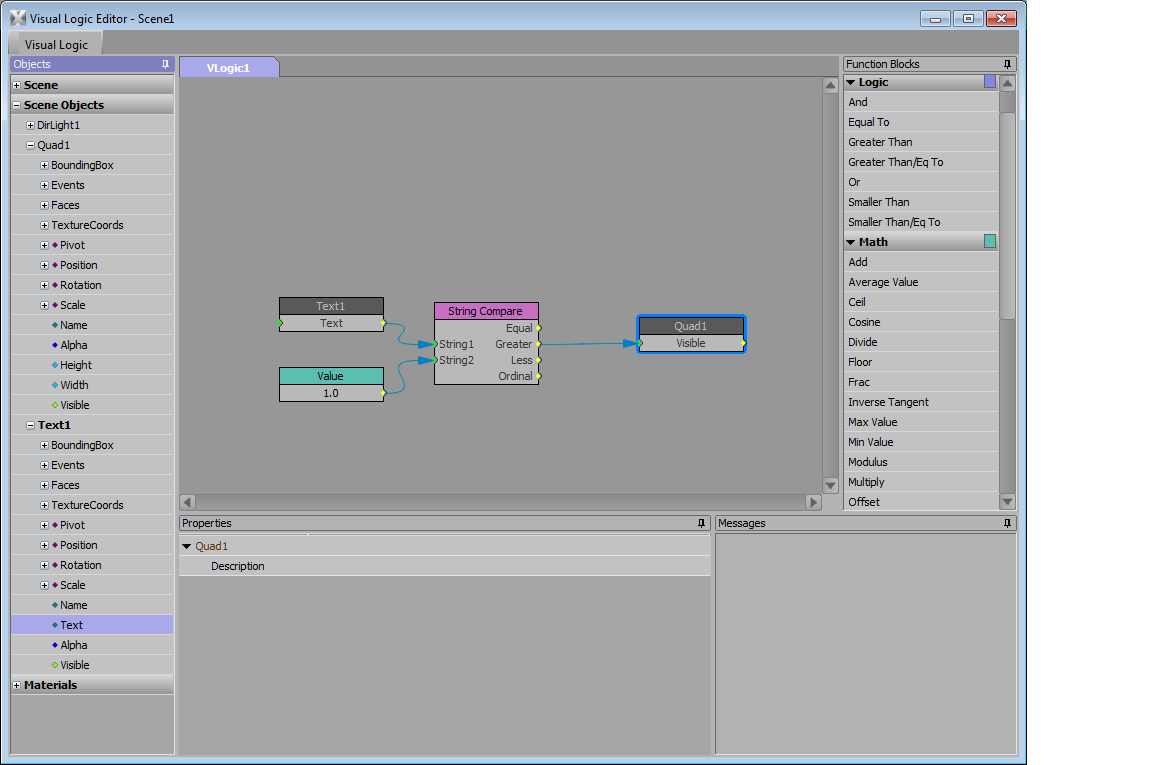

    I've accomplished something similar with Visual Logic. Link the "text" parameter of your text layer to String1 of a String Compare block and a Value of 1 to String2, then Link the String Compare output "Greater" to the visibility of your group. I'm working in Xpression Designer V5.5, so you may have to adjust for a newer version.
