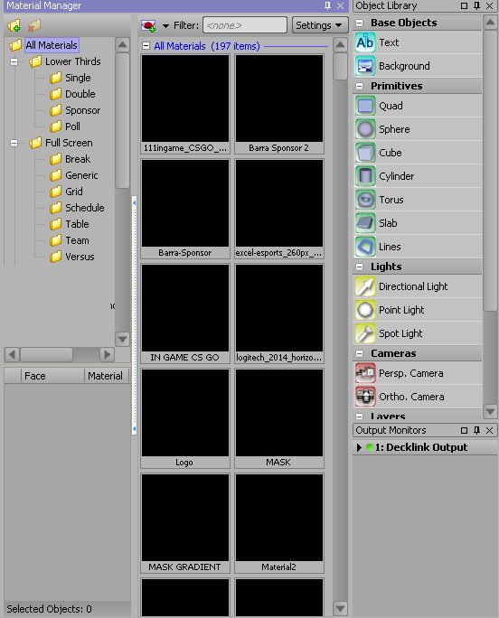

    Hi guys,
    I have one problem with xpression, every material I create or edit isn't showing in the material preview (pic01) just apear the black screen. Already try the support but after 1 hour trying to fix the guy just give up, I hope you guys can help!
    PC Specs
    i7 4930K
    16GB DDR3
    Windows 10 (already try with W7 and W8.1)
    Radeon HD7900
  • 2.  RE: Material Preview
    Posted 05-17-2016 21:40
    This is a sign you don't have an Nvidia graphics card. Xpression requires Nvidia specifically as part of it's render engine.
  • 3.  RE: Material Preview
    Posted 05-18-2016 01:19
    Tnks!
  • 4.  RE: Material Preview
    Posted 05-26-2016 22:44
    I see that on our systems that don't have the Nvidia graphics card also.
