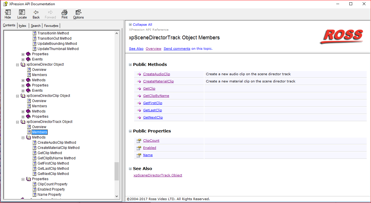

  • 4.  RE: Adding a programmatically created animation controller to a scene director
    Posted 04-19-2018 15:01
    Sure it does, see picture below.
  • 5.  RE: Adding a programmatically created animation controller to a scene director
    Posted 04-19-2018 15:03
    Hmmm!!
  • 6.  RE: Adding a programmatically created animation controller to a scene director
    Posted 04-19-2018 15:15
    Sorry, it's only in 7.1 and above:
    version 7.1 build 3869 (July 17th 2017)
    � [implemented] xpSceneDirectorTrack.CreateAnimClip to create an animation clip on the track
