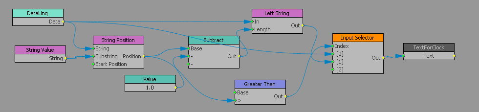

    Hey all,
    I getting data via an all-sport and once it gets to a 10th of a sec. it makes my clock look not centered. Is there a way to script so the 10th of a sec is not visible? Or can this be done with visual logic?
    Ryan
  • 2.  RE: All-Sport Scripting
    Posted 10-01-2018 23:18
    Here's some Visual Logic I believe should work!
    The Datalinq block is your Daktronics datalinq, the string literal value is "." (I'm assuming your time comes across something like 43.7)
    For the base value for the "Greater Than" block, put 0.
  • 3.  RE: All-Sport Scripting
    Posted 10-06-2018 07:30
    Thanks very helpful!
