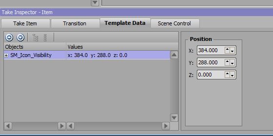

    I have 3 group objects in my scene, the whole purpose of which are to act as visibility toggles. I have these objects published, with only ID4 Visibility checked, yet in the sequencer these objects display controls for Position AND Visibility. Whats worse, I have to drill open the object to expose the visibility checkbox. This is not ideal at all, and will surely be a PITA to the operator, and open the whole thing up to failure.
    Any ideas?

    OK, I have attached a VERY basic XPression project containing a quad with a Twitter logo, and a Group Object which acts as its parent (This mirrors the setup in my main project, the parent setup was necessary to accommodate other functionalities. I also have a screen shot here that shows the position elements exposed in the sequencer... now, it doesn't appear to have any effect when I change the values, but just their presence could be confusing to an operator.

    Hi Willie,
    Yes that definitely looks like a bug in XPression. We will investigate it next week and look for a solution.

    Hi Willie,
    If you are eligible to upgrade; version 6.5 3642 should have a fix for this issue. It has not been through our QA process so it would be available as a beta version for you.
    Please contact Ross Tech Support.
