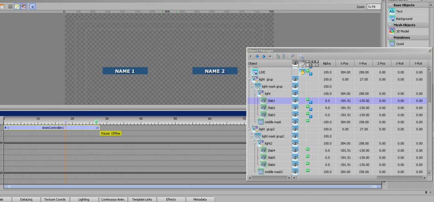

    I have some slab with animation.They are masked with layer objects.They are all in a grup.
    When i copy this grup and paste in same scene, grup copy with all objects but key frmaes on slabs not comes.
    in the picture below you can see it.
    Do i made something wrong or is it bug in v.7.0 (studio SCE)

    No bug. When you copy objects, only object are pasted. But you can now copy animcontroller and paste it on a scene director...

    When you copy and past an animation controller you will get the "paste" dialogue box, you can choose a different target other than the original object for the keyframes to attach to. If you have number your objects correctly you can just click "increment target" in the bottom left.
