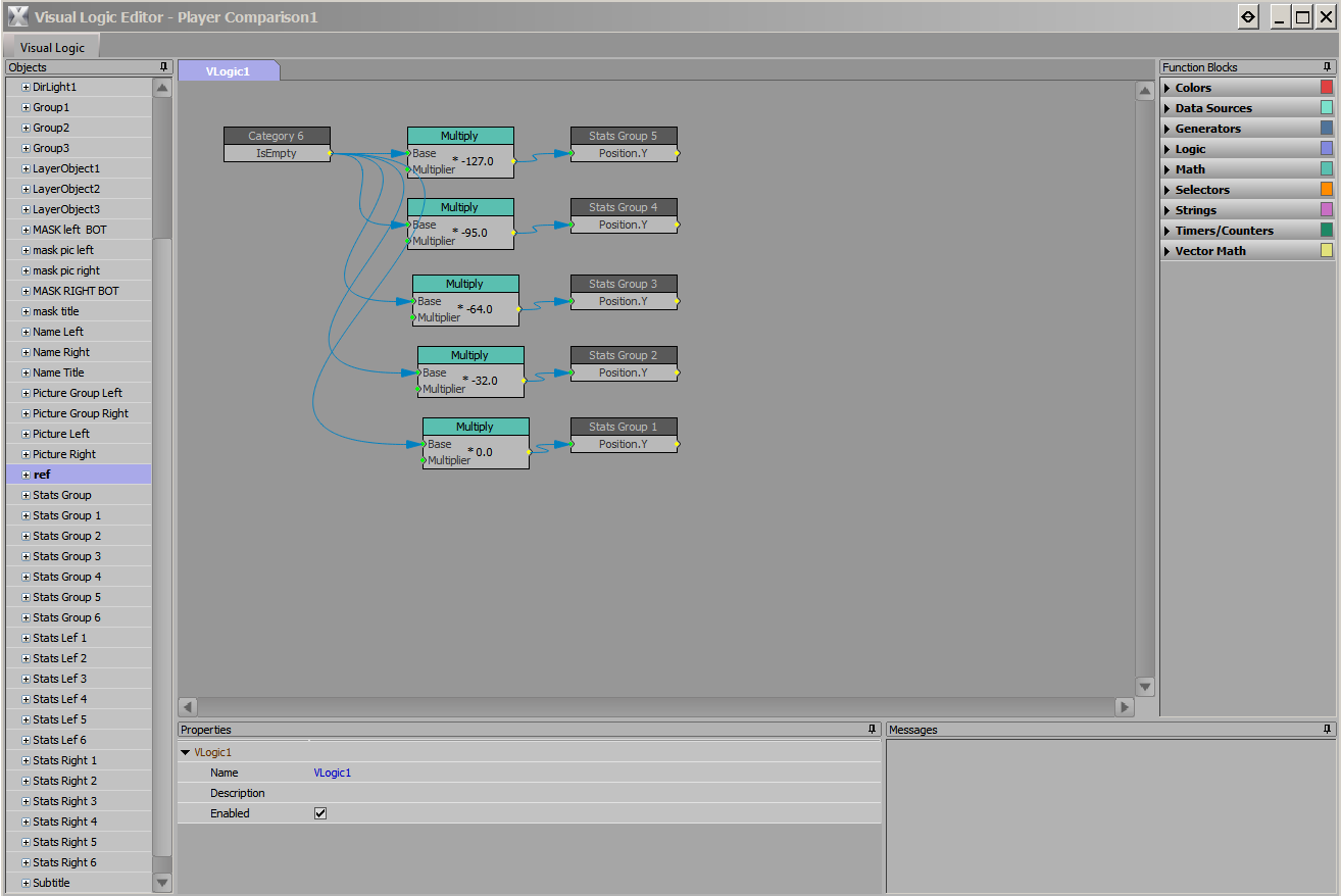

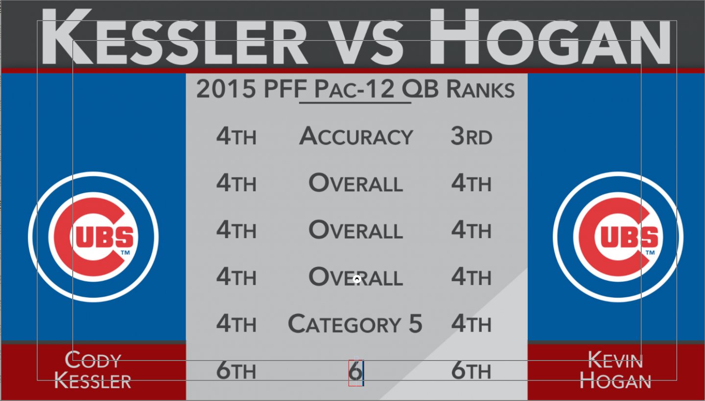

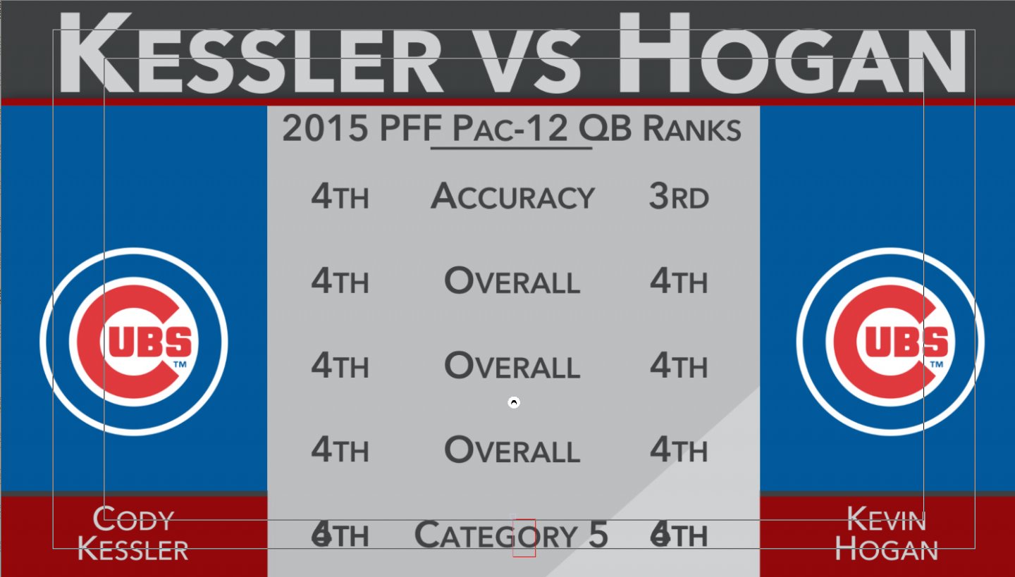

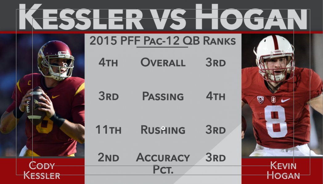

    We are in the process of creating a new graphics package and I am doing my best to simplify the amount of templates we have. Instead of having a template per amount of lines we need in certain fullscreens, I am trying to keep them all into one template.
    I was successful enough to create a 6 Line Comparison graphic and move into a 5 Line graphic by using the 'if empty' option in visual logic. I am trying to apply the same logic to make it a 4 Line graphic and have the lines move up. My problem right now is that it only does either or. Is it possible to make some sort of rule that says if Line 6 is empty, move to Line 5 settings, and if Line 5 is empty move to Line 4 settings?
    I am attaching a few images to make myself more clear. I would really appreciate the help. I feel like I've tried a lot of different combinations but I am not a pro at visual logic.
    Thank you in advance.
    Mildred

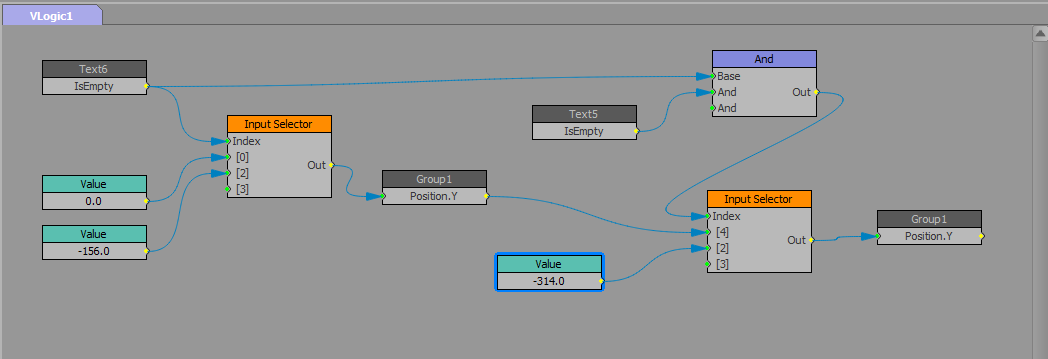

    Hey,
    If you're keen to use visual logic you could use something like this.
    I'm using a group for shift of the position but you can use the same logic.
