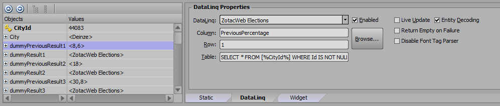

    I'm using a group inside the sequencer which will play in loop and will show Election-results. To make my life a little bit easier, I have used a Datalinq-key to specify the table in which my data is found. In my Datalinq I put a query to select the order of the results.

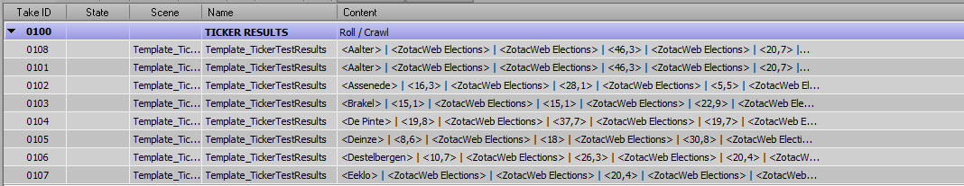

    When I test it in Edit Mode, everything is working fine. When I update the Datalinq-key, all the values update along. When I create the group with the Take Items which will play in loop, and I modify the Datalinq-keys for each individual Take Item, I can see in the list that the results are updated. However when I start the Crawl, I get the same results continuously. They are not even the results of the TakeItems in the group, but they are the results of the Template from Edit Mode.
    So it seems that the Datalinq Key inside the Group of a crawl are not taken into account when the group is being played. It is replaced by the value from the template.
    I've attached two screenshots to show that the values have been updated.
    But when playing this group, the values are shown wrong.
