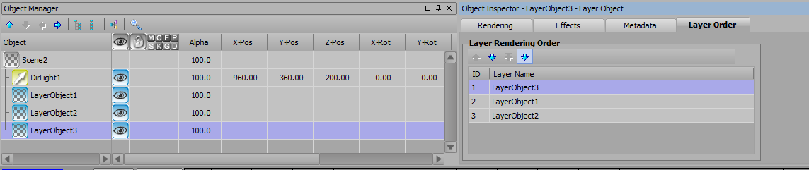

  • 5.  RE: How to Mask Away Text in Xpressions?
    Posted 11-13-2017 16:32
    Extra note on the layerobject, while it has no Z position you can change the order that layerobjects are rendered.
