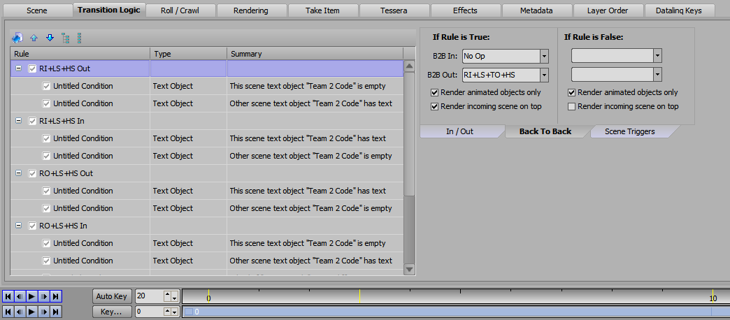

    Okay, so I considered the way it looks at the logic from the perspective of both and made separate rules for in and out for both the logo entering and exiting. However, it's running with whichever pair is at the top of the list regardless. Here's my logic list attached.
    Any ideas?

    I'll need to see the scene again.. Impossible to debug this just from looking at the screenshot.. It looks like you are on the right track though, having separate In/Out conditions with different checks..

    Actually, before I even download it, I think you'll want to remove the "no op" chosen scene director from the rules where you don't want it to use that rule.. Otherwise it will stop looking once it finds one that matches and it will just play the "no op" scenedirector. If you don't want it to play that, just leave the dropdown blank.
    Holy scene directors, Batman, I think we've got it! This appears to be making everything work as it should. Thank you for the tip(s)!!!
