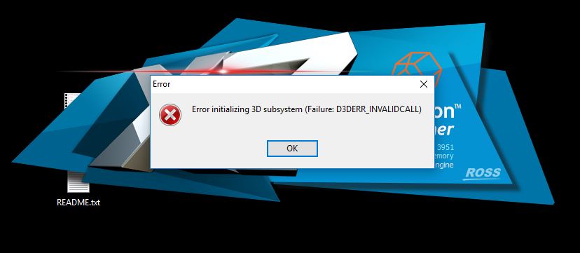

    Howdy guys,
    We installed XPression 7.1 on one of our machines today which previously didn't have it. The install itself went of without a hitch, but when go to launch it, we get the error message displayed below.
    Any ideas, what's going on, or how to fix it?

    Make sure you aren't using remote desktop at all.
  • 3.  RE: Error when launching XPression
    Posted 07-16-2018 13:41
    Make sure the NVIDIA card is set as the hardware renderer in preferences.
  • 4.  RE: Error when launching XPression
    Posted 07-16-2018 17:03
    Not using remote desktop to work in XPression, but it is configured on that machine for other tasks, I wouldn't think that would be effect it, but does it?
  • 5.  RE: Error when launching XPression
    Posted 07-16-2018 20:06
    No, if you aren't logged in through remote desktop then that is not the issue. Are you sure the machine has an NVIDIA GPU and it is selected as Garner describes?
  • 6.  RE: Error when launching XPression
    Posted 07-16-2018 21:21
    At the same time I made this thread I also put in a note to support with the mindset that the more lines you cast, the faster you'll catch a fish. So Brandon Derry gave us the idea to trash the pref.ini, and reestablish the GPU hardware path, and that seemed to do the trick. Said machine has a 1060, so I knew we were ok on that front.
    Thanks as always to you and Garner for the help!
