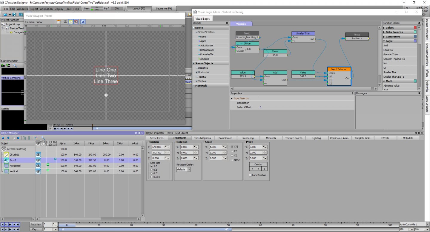

    Horizontal is just a center-justified text field.
    Vertical---there is probably a very simple script to make this happen, but I don't know it---the attached visual logic worked for me.

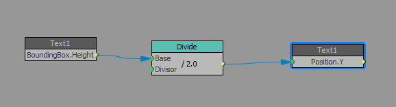

  • 3.  RE: How to Center Justify a Text field vertically and Horizontally
    Posted 01-24-2018 10:54
    To get a vertically aligned text with visual logic you only need to take the bounding box height and divide it by 2. If you place the text inside a group you can then move that text wherever you wish.
