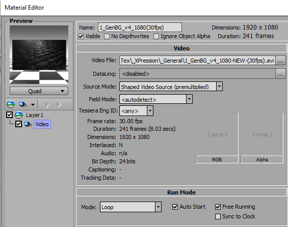

    No VL needed for this. In fact, the video needn't be in the scene director at all. Just make a video texture and apply it to the the quad or whatever you are using to display it. The key is in the material settings. Make sure you have Loop, Auto-Start, and Free Running checked, and you should be good to go. Here's an example from a recent project of mine:
