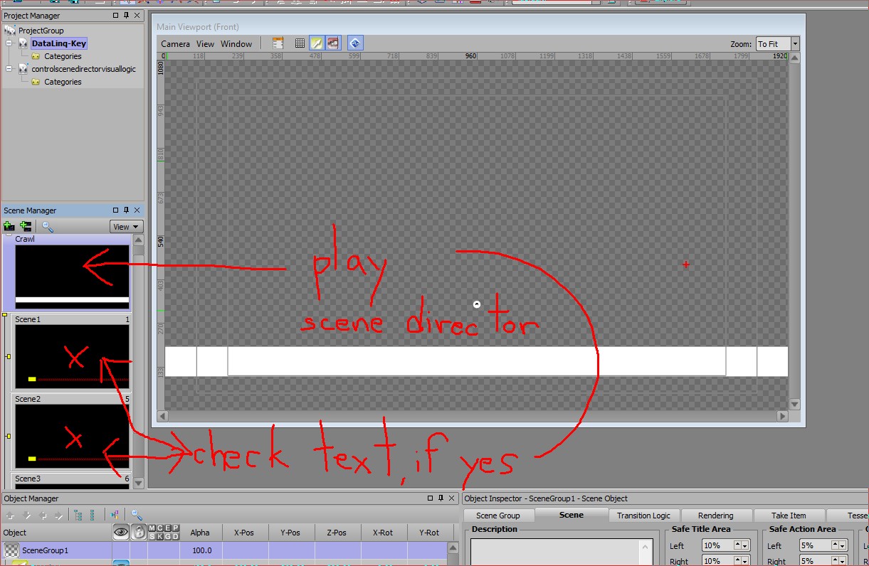

    I have no idea about coding. This is what I'm trying to do.
    I want to play a SceneDirector in the main SceneGroup. When a text object in child-scene contains value.
    Is there anyway to do that?
    Thank you.

    Red, it works but it's the other way around. In your sample, the parent scene controls the child scenes. Is it possible to make the child-scenes control the parent scene?

    I do this for a few scenes and it works well. In an event marker or similar, you can add this to the script:
    dim parentScene as xpScene
    Scene.GetParent(parentScene)
    Now you can access parentScene and use is as you normally would. Change colors, trigger animation controllers and scene directors, anything like that.
    Is this what you are looking to do?
    Hope this helps.
    Mike

    Thank you, Mike. It works like magic. Much appreciated!
