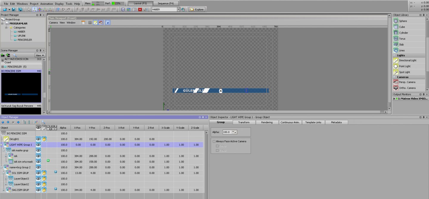

    I have 2 layer object that contains masks,i put these layer objects in 2 different groups.
    2 groups in same position,I want one of them send to back,but i couldnt.Z position didint work for gropus,in object manager ordering also didint work for me.

    you can see layers and result.I want send group1 (white stripes) to back bu anyway it still cover blue backgrounds.
    I changed group1 to upper but it didint work.
    Thanks.

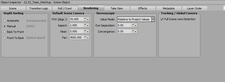

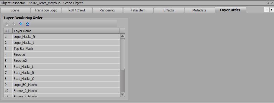

    Click on your scene object (the topmost item in your object manager. Click the Rendering tab, set the depth setting to Manual. Then, if this alone doesn't solve your issue, click on the Layer Order' tab (also within your scene object) where you can sort the way in which your layers are rendered.
  • 5.  RE: How to do Layer Object order?
    Posted 06-21-2017 18:35
    Layer order tab fixed the problem
    Thanks lot Willie.
