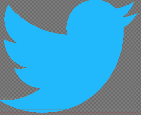

  • 1.  C4D Object fine but export as OBJ or 3DS and import to Xpression loooks like pixellize-aliasing
    Posted 04-28-2017 01:16
    How to fix pixellize obj file when import to Xpression.In C4D its look good.I tried with antialias and increase indermedate points to make softer but not works.
  • 2.  RE: C4D Object fine but export as OBJ or 3DS and import to Xpression loooks like pixellize-aliasing
    Posted 04-28-2017 23:55
    It's hard to tell from that photo exactly why that is happening, but the bigger question is, being that this is a flat logo, would it not be better simply brought in as a png texture with an alpha and mapped to a quad?
    As for the image, it really just kind of looks like you are looking at your viewer at a value other than 100%. Also,have you put this in your sequencer to see a better approximation of final output would be? Sometimes things can look a little off in the editor view, but be fine in output.
  • 3.  RE: C4D Object fine but export as OBJ or 3DS and import to Xpression loooks like pixellize-aliasing
    Posted 04-30-2017 18:50
    thanks.
    it was my settings issue :) .anti allias problem.now its better.
