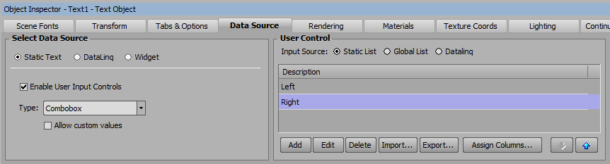

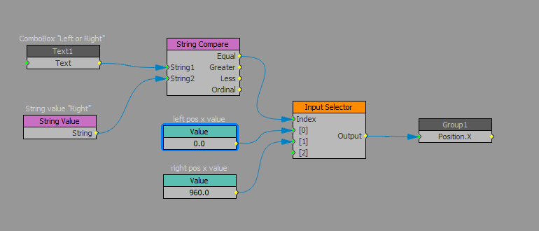

    The easiest way is user input box (photo 1) and visual logic (photo 2).
