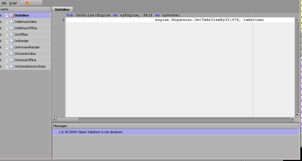

    Thanks for replying bamboo.but iam not familiar with scripts :(
    When i paste code,cahneg take id number and click on flash symbol after that one error comes.
    it says :'' takeitem is not declared''
    after that i write scene name ''crawl ''
    but than ''crawl'' is not declared. comes.
    whats wrong ?

    Sorry, I forgot a very important first line:
    dim takeitem as xpBaseTakeItem
    that should be the first line of the script. Apologies.
