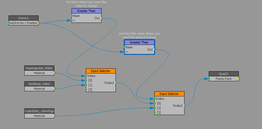

  • 3.  RE: Choppy video animation and adding background to all full frames
    Posted 11-13-2017 16:11
    With visual logic you could flip out the materials as the playhead animates by using the greater than block and input selector.
    In this example I placed 3 videos on the time line and this enables 2 changes but you can just keep adding to what I did to add more changes.
  • 4.  RE: Choppy video animation and adding background to all full frames
    Posted 11-20-2017 14:34
    Thank you both, this helps with the choppy playout! I my case one Input Selector was enough, the user just types the number of lines that are desired visible and the corresponding video is linked to that number in the selector.
