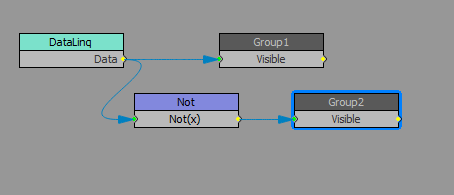

    Hey, you'll want to use visual logic. Send a 0/1 from a dashboard button to a datalinq block in XPression connected the visibility of what you want to turn the visibility on / off. Photo 1.

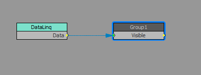

    If you want to control 2 groups you can use a "not block" this will alternate between groups. Photo 2.

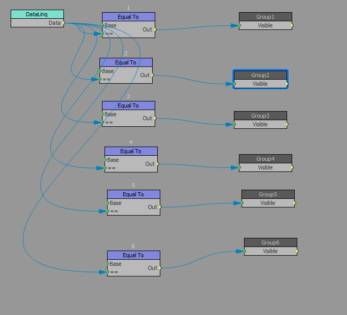

    If you want to control multiple groups you can use the following method however you need to send a range of values from dashboard 1 -6. Photo 3.

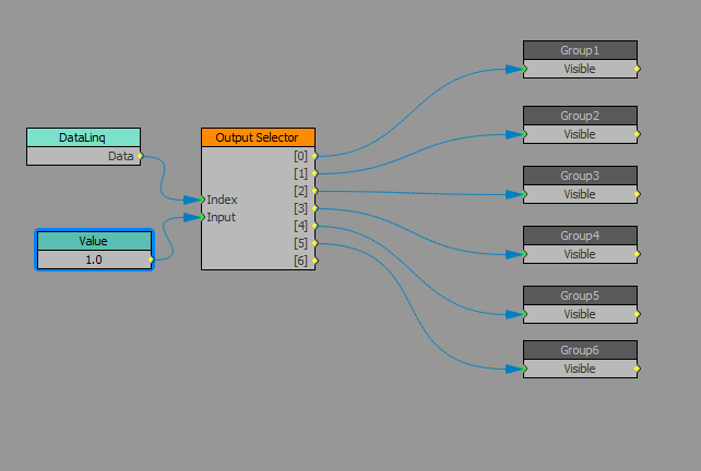

    In the next version of XPression, the above will be easier with a new block called "output selector". Photo 4.
