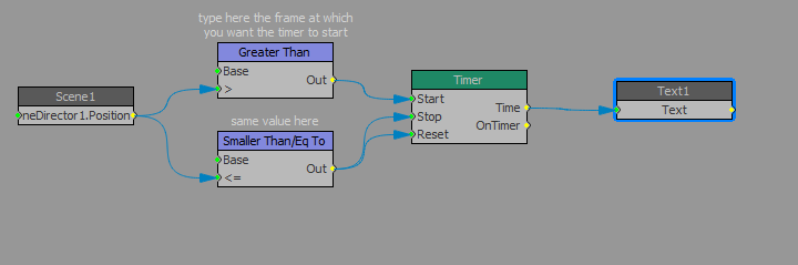

    Alternatively, you could build your timers in Visual logic instead, you get the same controls and the widget in the timer block you just need to output that to a text block that is set to static rather than selecting widget as the input. "‹

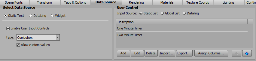

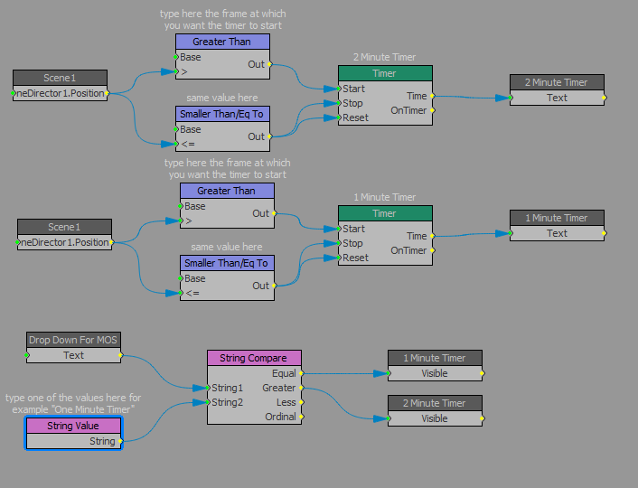

    Hey, here's the rest of the logic if you wanted it.
    And here's my combobox settings
