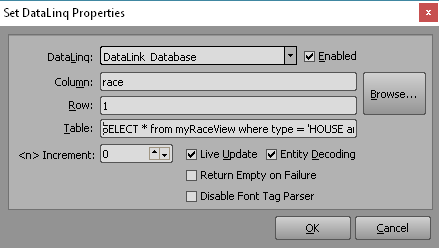

    Is there any trick to getting a simple SELECT statement to work when entered into the Table field in the DataLinq object properties in XPression?
    The DataLinq source it refers to has "force datalinq to use a fixed table" unchecked.
  • 16.  RE: Modifying a DataLinq query in VisualLogic
    Posted 03-21-2018 16:19
    When I enter "select * from MY_TABLE" into the Table field, the Browse button returns nothing.
    However, when I enter simply "MY_TABLE", Browse returns the table.
    How were you able to use "select * from..."? I will need this when I want to specify arguments with "select * from MY_VIEW where...".
  • 17.  RE: Modifying a DataLinq query in VisualLogic
    Posted 03-21-2018 16:29
    with SELECT in uppercase it should be better
  • 18.  RE: Modifying a DataLinq query in VisualLogic
    Posted 03-21-2018 18:10
    Thank you
