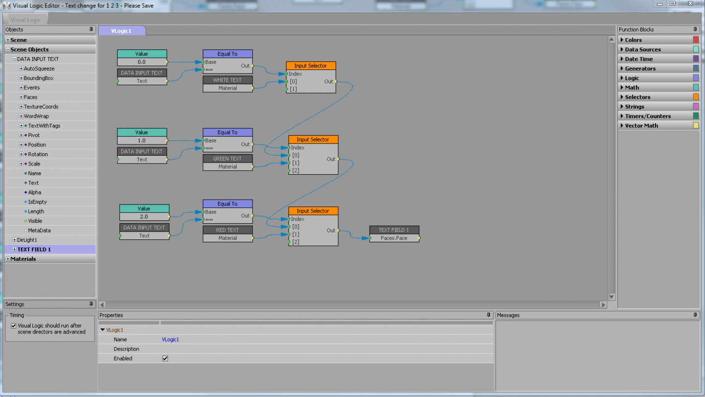

    I am trying to use a data source (Data text 1) that gives me numbers of 1, 2 and 3 to change the color of a different text field (Text Field 1). For example, 0 = White text, 1 = Green text, 2 = Red text. I am trying to accomplish this through Visual Logic. Any thoughts?

    I think I figured this out:

    It is actually a bit simpler. Delete those value and equal to boxes and just use one input selector. Make your text the index and connect each material to the number they correspond to. Everything else is just redundant.

    Works great. Thank you.
