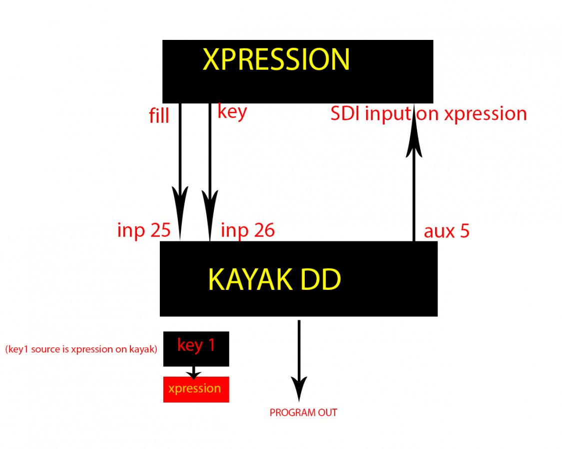

    My xpression connected Kayak DD switcher input.Also I control Xpressin on switcher with key button.And I connect an aux from switcher to Xpression SDI input.
    We created a transition for phone.In this transition there is a live source.
    On my program monitor and aux source is same.For example Cam1.
    So,program monitor & xpression live source are same source.Key1 is activ.
    when I call phone transition ,during the live source cover up program monitor its jumping.Itsa not too much but you can see it.
    My project is sd 4:3 (DV/pal), kayak DD is SD.
    How can I fix this problem?

    This only happens if you have the same source in the aux and program right? If you put a different source into the aux it doesn't jump, right?

    Thats right.If I put on differnt source on program you can not see difference because your eyes can not see between two sources,it hapens fast :)
    For to better understanding: I dont use any trigger device, I cover up program when i call video transiton and live source.Live source alpha is 0, when i call it will be 100.
    So jumping happens in this time.And it happens when take item off and main program appears.
