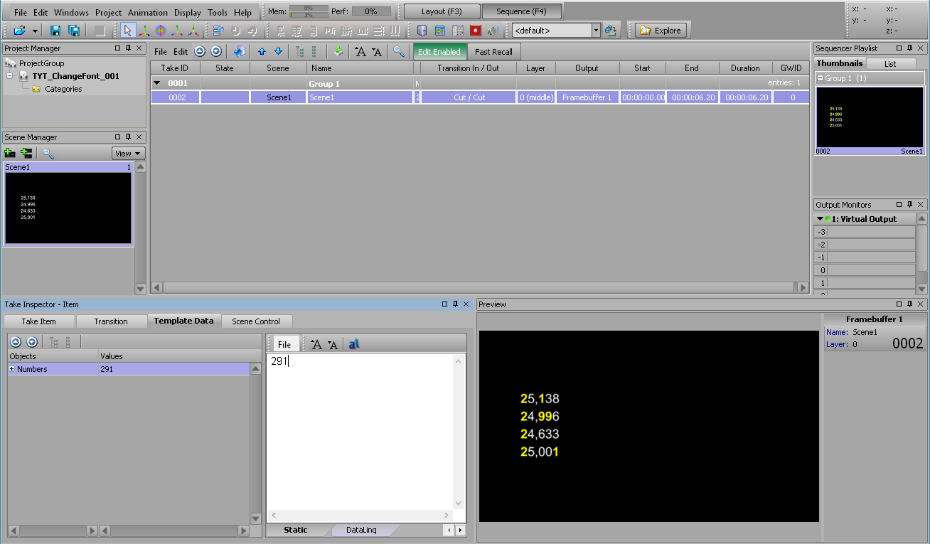

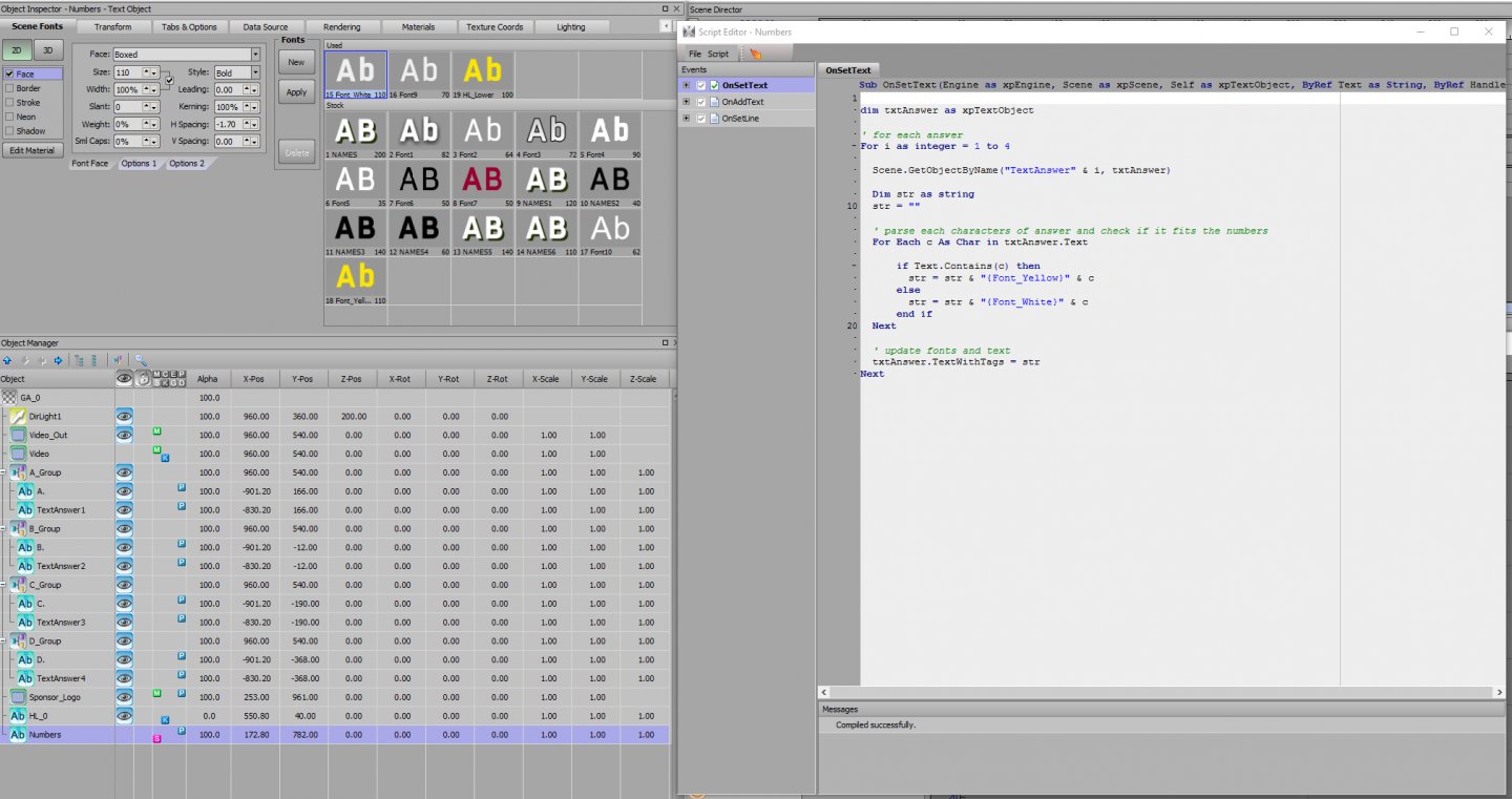

    with scripting , you can use TextWithTags property to do the highlighting trick :
    for each characters in the answers, check if it match the numbers that have been played and change font tag accordingly.
    For example : if 2 9 and 1 have been played , for answer "25,138" you will set :
    textObj.TextWithTags = "{Font_Yellow}2{Font_White}5{Font_White},{Font_Yellow}1{Font_White}3{Font_White}8
    See project sample in attachement : script Numbers.OnSetText .
    You can change values in sequencer mode to test it dynamically.
    Hope it helps,
    Antoine.

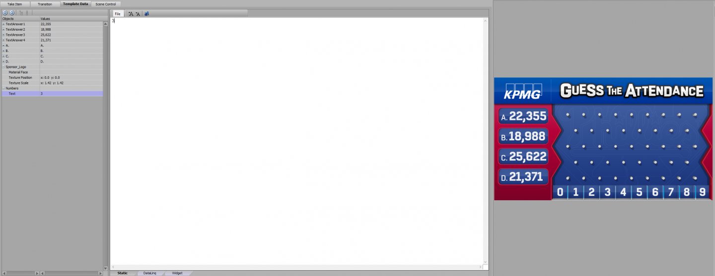

    So, I have tested Antoine's scene, and it works there perfectly.. however, when I attempt to implement this on my own scene, it is as if the script is ONLY evaluating the first character in the number string and subsequently highlighting the entire 5-digit number. I have literally copy/pasted his script into my scene, and named everything involved exactly the same in order to eliminate as many variables as possible. Screen shots below show the whole-number highlighting behavior, nothing highlighting when a number is chosen which is in a string but not at the beginning and my Object Manager and script window. the ONLY difference between the sample scene and mine is that my TexAnswer objects are published...
  • 10.  RE: odd scene setup advice
    Posted 03-14-2018 00:46
    Update - I unpublished the AnswerText objects and the script does indeed work... so, this begs the question, how do I let the operator enter values for the AnswerText Objects if they need to remain unpublished?
