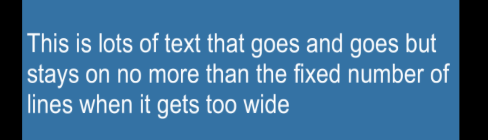

    With this new script, there is a glitch : first lines are often smaller than the last ones , that's not very natural or pleasant to read .
    Example with 3 lines of text :
    Before applying text.autoSqueeze = true , if we can parse again the text with the new current boxingbox.width , this seems to be better most of the time :

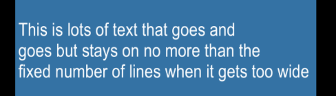

    For anyone who may be looking at this 6+ years later, I ended up using this claude-assisted script to evenly distribute the text across a designated number of lines:
