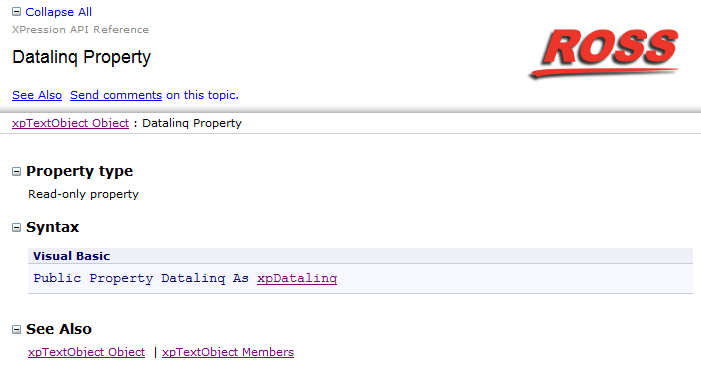

    I saw that the xpDatalinq property exists, and I've tried writing to it but I keep getting hit with read only issues.
    For example, attached is a picture of the xpTextObject.Datalinq property which is read only
    nvm i'm an idiot, please ignore
  • 4.  RE: [Question] Will the datalinq property ever become public?
    Posted 04-27-2018 18:28
    To clarify for everyone else, the xpDatalinq property is read-only, but the public properties of the xpDatalinq property are read-write. So you can write a string to xpDatalinq.Column for example.
