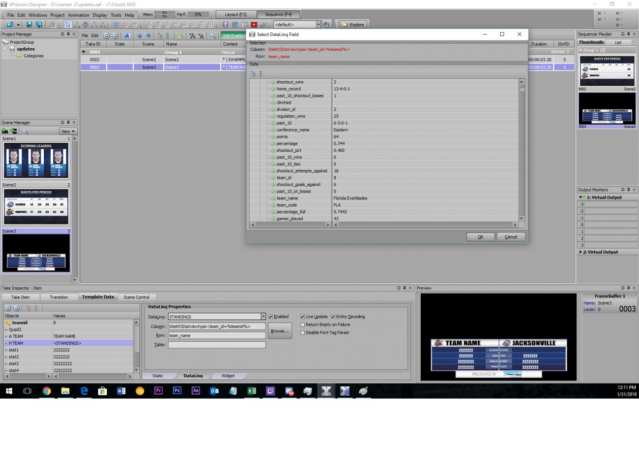

  • 4.  RE: Linq from rss feed not showing up
    Posted 01-31-2018 17:17
    im still having the problem. here is a pic of my settings if you see a problem. if i set to return empty on failure the text just disappears. even on my shot by period graphic if i do a direct link to the data it still wont pull
  • 5.  RE: Linq from rss feed not showing up
    Posted 01-31-2018 19:01
    Hi, thanks for following up..
    I was testing with a newer version than you. The version you are running had a bug in the JSON search queries that prevented it from finding the correct team_id.
    Please contact Tech Support, and ask for version 7.0-3831; that should resolve your issue.
