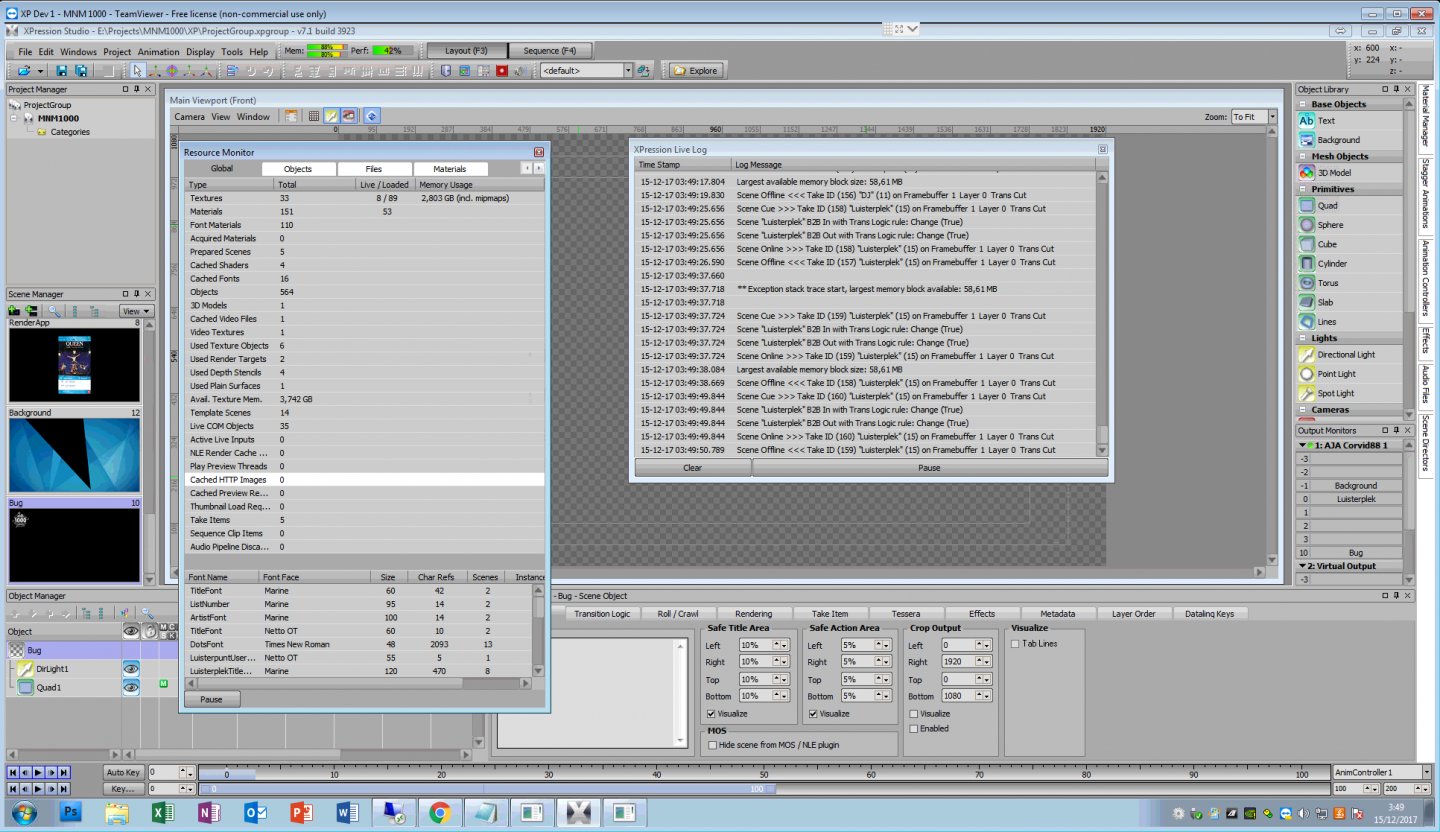

  • 4.  RE: Flush Texture Cache through API
    Posted 12-15-2017 05:31
    Attached you'll find a screenshot showing the behaviour.
    The strange thing is that I'm not getting any notification of no more space available or something like that, it just keeps repeating the same picture for a little while.
