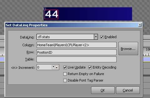

    Just want to clarify the issue a little bit. In this image, I'm pulling the jersey number of the second player in the record (which is where the <2> comes from) but his jersey number is 44.
    This is in contrast to how excel does it, where your jersey number can match the row number and you can easily use a relid in your datalinq. I don't see how I can get that to work with this xml file. Any ideas would be appreciated.
  • 3.  RE: XML datalinq
    Posted 05-11-2017 17:02
    You can replace the <2> with to fetch the record for player number 71.
