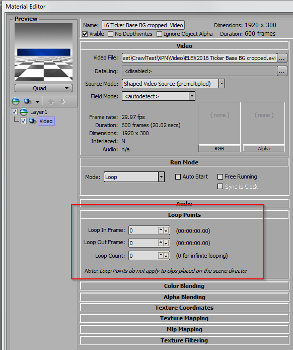

    Actually newer versions make 3 point loops even easier, as you can define the loop points directly in the video material rather than needing to use a scene director or animation controller. This works very well with the new transition logic feature.

    Posted 02-04-2016 18:07
    Fantastic, @bford ! Glad to see this in the new version.
  • 8.  RE: Back to Back fullscreen check
    Posted 02-06-2016 01:59
    Very pleased to do away with the multiple scene directors. Thanks.
