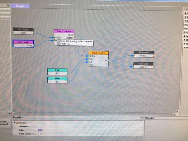

    I am having issues getting a String Compare to "read" my String Value. My Text and String Value should be equal with a value of "TCU", but the string compare still reads the value as 0. I'm attempting to change a logo size based off of a certain text (TCU). I am very new to Visual Logic, and I have not found a work-around.
    I provided a photo of the script. I appreciate any help.

    Would you be able to upload a sample project to dropbox or a shared google link? I'm not visually seeing anything wrong in the picture; but it's easier to debug if I can actually load the scene.

    Are you testing this from the viewport, or from the sequencer? If in the layout viewport; you need to enable the "Blue diamond" for visual logic to be executed. Have you done that?
