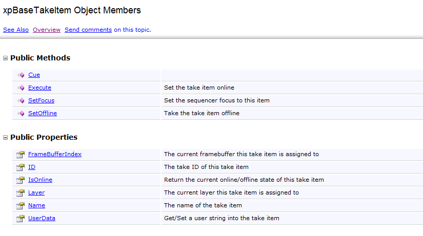

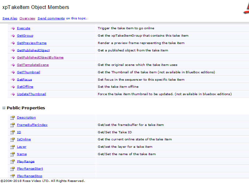

    The difference between xptakeitem and xpbasetakeitem is the object members that are available
    Ctype is used to convert an expression to a different type(object for example) in the script I convert basetakeitem from a xpBaseTakeItem to a xpTakeItem
