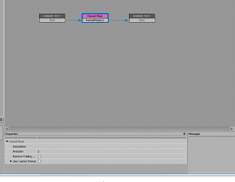

    I work with an RSS feed that gives us data for stocks. I have the visual logic set up to limit values after decimal points to 2 spaces.
    I would like to keep this logic but somehow enable the value to accept N/A when data is not available. Currently when I get an N/A value, the text comes up 0.00. When I try to select static text in place of data, it does nothing. Is there a way to do this?

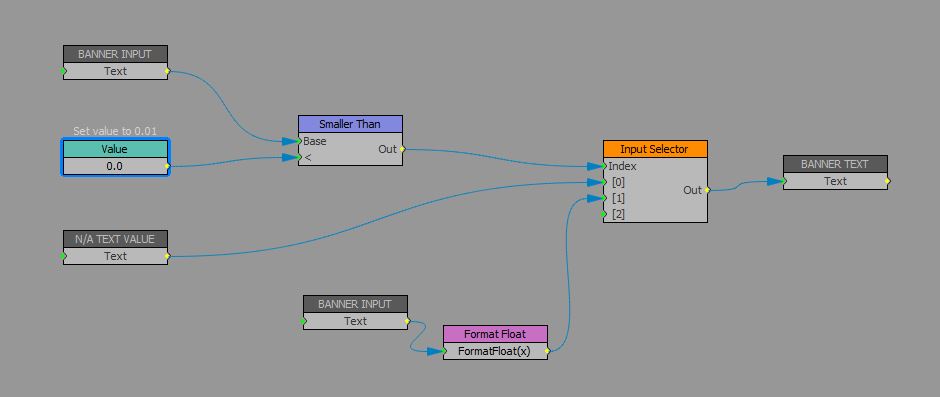

    Would this work for you? I may have over simplified it. Where "N/A TEXT VALUE" is simply "N/A" (which is hidden) and used just for comparison. I gave you an input field that is also hidden so that you don't get into a loop. I hope this helps, let me know.

    Ah, I see what you mean. I thought that the data output actually was "N/A". So, in theory the field will output a blank until actually data shows? You could do a visual logic block that displays the text "N/A" if the value of the text field is below .01. Otherwise it would pass the data on and display it. Let me play around a bit.

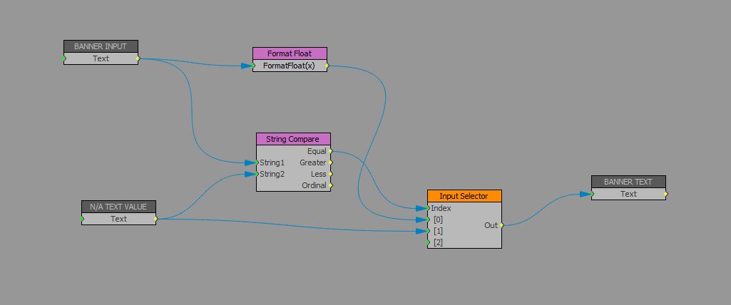

    Give this one a try.

    I think this works. Thank you!

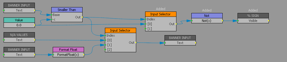

    I am trying to take this one step further now. For one of the data streams, we use percentages. For this particular field, I have a % sign as a separate text field than the data number (the data field does not show a % sign, so I added it myself) It is a child of the data number so it can move according to the length of the number. Is there a way to make the % sign visible when a true number is coming from data, but not visible when the value is N/A?

    Way to go. Does this add a % sign? What does the "Not" block do?
  • 11.  RE: Visual Logic - Decimal Points and N/A
    Posted 03-02-2018 13:38
    The % sign is already in the scene as a separate text object. Some of our data must be shown as percentages, but our RSS feed does not include the % sign so I had to add it. The NOT block just tells it to show the % sign when a numerical value is present or to not show it when the data comes up N/A.
